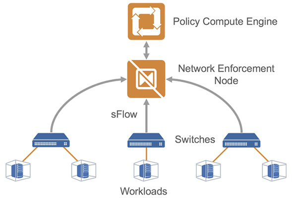

How the NEN Receives Switch Data
With the NEN, network administrators can configure their switches to send sFlow data to an sFlow collector, such as the NEN. An Illumio Core administrator can configure the NEN to listen for sFlow data from switches and associate workloads to those switches. The NEN receives sFlow data directly from the switches, summarizes it, and uploads it to the PCE. You can view this traffic flow in the Illumination® map and stream it out of the PCE through UDP in Splunk, CEF, or LEEF formats.

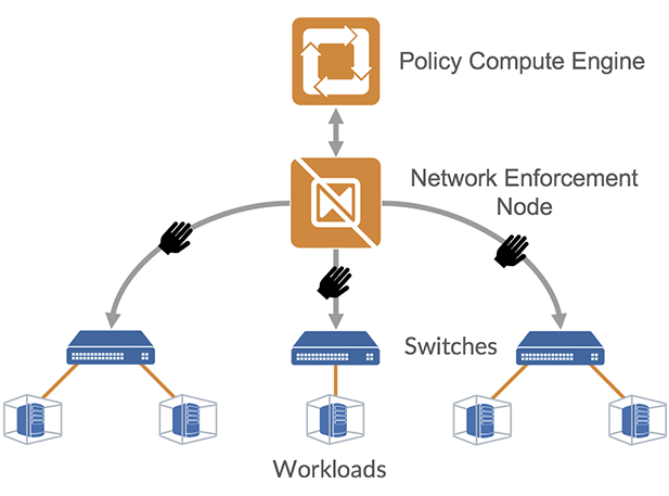

Illumio administrators can use the NEN to convert natural language policies into ACLs, which the switches understand natively. Your organization's teams that use Illumio Core can download ACLs from the PCE and provide them to the networking team for review before applying new policies to the switches.

Workflow for Setting up NEN Switch Integration
This following is an overview of the steps required for working with the NEN for switch integration:
  1. In the PCE web console:
    1. Define the switches.
    2. Create unmanaged workloads.
    3. Assign those unmanaged workloads to switch interfaces.
    4. Create security policy rules to protect the workloads attached to the switches.
  2. Use the PCE REST API or the PCE web console to generate switch ACLs based on your organization's security policies.
  3. Copy and paste the generated ACLs to configure the switch via the switch's command line.
  4. Using the PCE REST API or the PCE web console, inform the PCE that the ACLs have been loaded.
Result: The PCE-generated ACLs on the switch will protect the target workloads.
