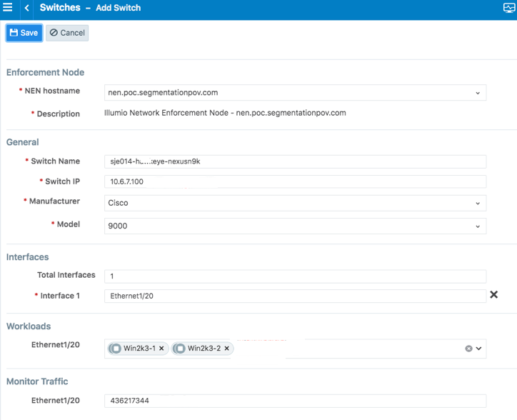

Add Unmanaged Workloads and Switch Definitions in the PCE Web Console
To create a security policy, the switches and the workloads attached to them should be defined in the PCE web console as follows:
  1. Log into the PCE web console.
  2. Define the unmanaged workloads that are attached to the switch by selecting Workloads and VENs > Workloads > Add > Add Unmanaged Workload. You will associate these unmanaged workloads with their switches later.
    See the Security Policy Guide for information on adding unmanaged workloads.
  3. Define the switches and associated workloads, by selecting Infrastructure > Switches.
  4. Click Add.
  5. Enter the details in the displayed fields as described in the table below.
  6. After entering or selecting values for all the required fields, click Save.
Fields in the PCE web console > Infrastructure > Switches > Add Switch page:
Field Name
Required
Notes
NEN hostname
FQDN of the NEN that runs the NEN service
Yes
This field is populated with the FQDN of your NEN. You cannot edit this field.
Description of the NEN service
Yes
This field is populated with "Illumio Network Enforcement Node" and the FQDN of your PCE. You cannot edit this field.
Switch Name
A free-form, mnemonic name of your choice for the switch
Yes
Make this name easy to remember and distinguishable from other switch names.
Switch IP
IP address of the switch
Yes
Corresponds to switch_IP_address that you defined in Configure sFlow on Cisco Switch. It is also known as sflow agent-ip in Cisco switches.
Manufacturer
Name of the switch manufacturer
Yes
Select Cisco.
Model
Model number of the switch
Yes
Select 9000.
Interfaces
Defined interfaces on the switch
No
Corresponds to interface_name_to_monitor you defined on the switch and configured in Configure sFlow on Cisco Switch. This can be a custom string.
You can also add interfaces that are not monitored by sFlow.
Workloads
Names of workloads connected to the switch's defined interfaces
No
Only those workloads assigned to the switch interfaces are secured.
You can attach one or more workloads to an interface.
Monitor Traffic
SNMP ifIndex of the switch interface
See Collect SNMP ifIndex Value for Cisco and Collect SNMP ifIndex Value for Arista.
Yes/No
If the interface is monitored by sFlow, the Monitor Traffic field is required.
