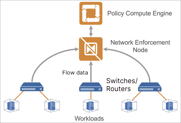

How the NEN Receives Switch Data
You can configure your switches to send flow data to a flow data collector, such as the NEN. An Illumio Core administrator can configure the NEN to listen for flow data from switches and associate workloads to those switches. The NEN receives flow data directly from the switches, summarizes it, and uploads it to the PCE. You can view this traffic flow in the Illumination® map and stream it out of the PCE through UDP in Splunk, CEF, or LEEF formats.

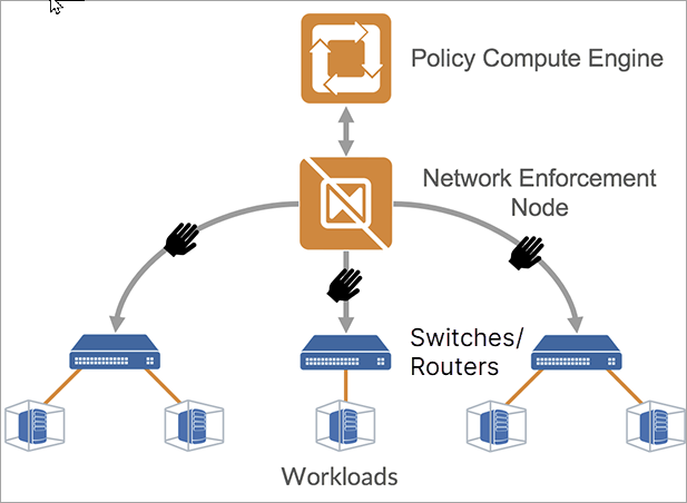

Extended Policy Model
The Illumio policy model encompasses workloads with native stateful firewalls built-in, such as Linux iptables or Windows Filtering Platform. Although all systems might not have a firewall built in, they still have segmentation requirements. To solve this use case, Illumio has extended its policy model to switches.
Illumio administrators can use the NEN to convert natural language policies into ACLs, which the switches understand natively. Your organization's teams that use Illumio Core can download ACLs from the PCE and provide them to the networking team for review before applying new policies to the switches.

Workflow for Setting up NEN Switch Integration
The following is an overview of the steps required for working with the NEN for switch integration:
  1. In the PCE web console:
    1. Define the switches.
    2. Create unmanaged workloads.
    3. Assign those unmanaged workloads to switch interfaces.
    4. Create security policy rules to protect the workloads attached to the switches.
  2. Use the PCE REST API or the PCE web console to generate switch ACLs based on your organization's security policies.
  3. Get the generated ACLs on to the switch either manually or automatically, depending on your integration method (UI or API) and the switch model:
    • Cisco Nexus 9200 and 9300 series switches; Arista 7000 series switches: Use the switch's command line to manually copy and paste the generated ACLs to configure the switch.
    • Streamlined OVS integration through the PCE API: If you are integrating with OVS via the PCE API, you can enter the IP address and credentials for the OVS switch and the NEN will automatically:
      • Discover the switch configuration
      • Program flow monitoring on the switch
      • Discover and creates workloads in the PCE
      • Program the ACLs on the OVS
  4. Using the PCE REST API or the PCE web console, inform the PCE that the ACLs have been loaded.
Result: The PCE-generated ACLs on the switch will protect the target workloads.
